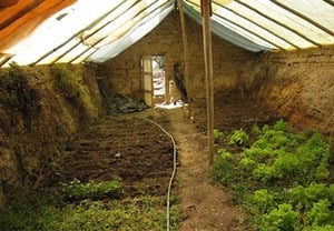

How would you like to have fresh vegetables and fruit year round? Sounds pretty good right? Having an underground greenhouse will keep the temperatures hot in the winter and help prevent overheating in the summer; making it possible to grow your garden vegetables through the cold winter months.
How it Works
We all learned in school that under the earth’s crust is magma which heats the entire sphere. Surprisingly, if you dig down 4 feet, the heating process becomes apparent. For the vast majority of the planet, 4 feet below the surface will stay between 50° to 60°F even if the weather above the ground is 10°F with a cold wind! This phenomenon is called the thermal constant and it’s what the underground greenhouse thrives on.
The original design for an underground greenhouse was invented in Bolivia and was called a walipini, an Aymara Indian word which means “a warm place.” Typically, a walipini is a rectangle shape that is 6-8 feet deep in the ground. The longest area of the rectangle will typically face towards the south (in the Northern Hemisphere) to take advantage of the most sunlight.
Since the walipini is taking advantage of the thermal constant, it requires less help from the sun to heat the greenhouse.
The design of the underground greenhouse isn’t that complicated. It can be as simple as a hole with plastic sheets laid on top. The roof seals in the heat and insulates the area to keep a warm, moist environment for your fruits and vegetables.

The angle of the roof will make a big difference on the sun’s ability to heat your greenhouse. Ideally, the roof should be facing directly at the winter solstice at a 90 angle. This angle will maximize the heat during the winter solstice and minimize the heat during the summer solstice.
The angle of your roof will depend on your latitude. Find a reliable map and figure out your latitude and then add 23°. This number will be the angle of decline that you will need on your roof. The majority of the United States runs between 30-50° Latitude. That means that the internal angle of your roof will need to be between 53° to 73°.
This is where the extra soil that you excavated comes in. Use that soil to create a berm. The berm is basically an extension of the north wall of the greenhouse. This allows you to control the angle of the roof by adding or taking away dirt. Build up the berm continuing the slope that you used on the wall. If you’re using bricks – continue using them on the berm.
Building the Roof
Recheck your berm to ensure that the angle of the roof will be between 53° to 73°. Once you’re sure that the angle is right, you can begin laying your roof.
The most economical, durable material for your roof is 4-inch PVC pipe. Using PVC elbow pieces, joiners, etc, you can create a flat roof frame that will cover your underground greenhouse.
After you’ve created a PVC frame, lay it in place on the top of your hole. Then lay plastic sheeting across the top of the frame and make sure that it extends past the edge of the frame by at least 1 foot. This flap will prevent run off water from the roof from running back into the greenhouse itself.
You might even consider installing a rain gutter along the bottom edge of the greenhouse to catch the water that runs off the roof and direct it into a different location that won’t affect your greenhouse.
Once you’ve laid the plastic material on top of the roof frame, move inside and tack another layer of plastic wrap along the inside of the roof frame. This internal plastic sheeting will create a 4-inch barrier between the inside and outside of the roof. This will act as an insulator that will keep the heat in more effectively.
You’ll want to make sure that you leave a few inches of plastic hanging down on the lower (south) end of your roof. This will force moisture that collects on the roof to drip off above the drainage system or on top of your plants instead of at the base of the roof. If you allow the moisture to run to the base of the roof frame, it may affect the soil at that location and break down your wall, etc.
